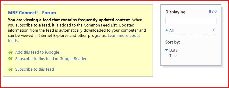

I am using the kunena component version 1.5.9 in a joomla based website. The forum works well with all the posts but the problem is with the rss feed. When I click the rss feed I dont see any feed results.
Initially I had the following problem.
Invalid xml declaration.
Line: 2 Character: 3
<?xml version="1.0" encoding="utf-8"?>
I removed the above line in the kunena.rss.php file. With this i could overcome the above error but I still dont see any of the forum posts in the feed result page.
I have attached the image file which doesnt contain any rss posts.
Could anyone please help me with this issue.
