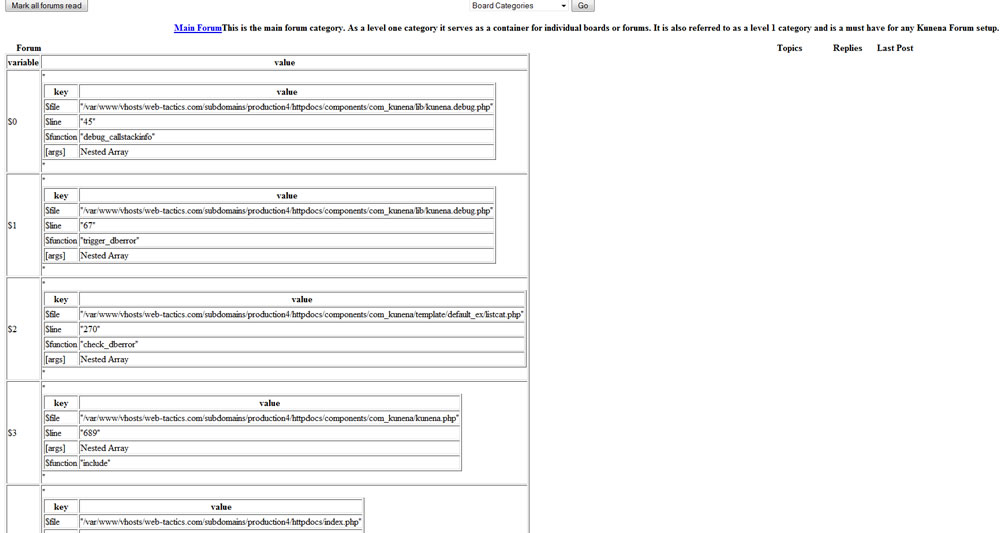

I have installed the very newest version of Kunena:
Installed version: Kunena 1.0.10 | 2009-05-21 | 1344 [ Parier! ] | php 5.1.6 | mysql 4.1.20
Everything works EXCEPT clicking the "Categories" Tab. That breaks Kunena and yes, I get the dreaded all white page - screen shot attached.
I do not have any components installed on my Joomla! 1.0.15 Stable site except sh404SEF and I have turned that off and I still get the broken white page when I click the "Categories" tab.
I have also uninstalled and reinstalled 3 times. :blush:
Screen shot attached.
Please help!!

17 years 5 months ago - 17 years 5 months ago #17773 by sozzled
I'm getting the impression that Kunena 1.0.10 has serious repercussions if people attempt to install it on a J! 1.0.15 site. We need evidence that K 1.0.10 operates smoothly, without problems, on a J! 1.0.15 site. I won't be rushing to do this: I have as much interest in J! 1.0.15 as I have in practising to conjugate Latin verbs :X
marleyman: this may not sound very comforting, but yours is the third case that I've come across in these forums dealing with problems associated with Kunena 1.0.10 on a J! 1.0.15 website. I also have my suspicions that J! 1.0.x may be involved in this case reported today, too: Search not working . Although these problems are very different to yours, there's a growing list of coincidences pointing to J! 1.0.15 as a possible common cause of problems.
Similarly - this isn't very comforting, either - I haven't seen these problems in a J 1.5.x environment. There is a different symptom with the K 1.0.10 search function under J! 1.5; I don't know if the solution in that case will help you, though.
Can you reproduce the same error situation on a J! 1.5.x website using the same combination of components that you have on your problem site?
