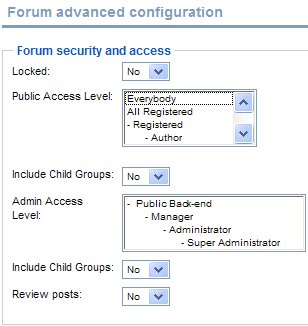

Can I confirm the Kunena forum settings, please?
You did not select any value for Public Access Level. You selected "Manager" for Admin Access Level. Have I understood these correctly?
