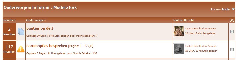

If I install the default_ex template, the height of the rows in thread view is higher than I want it to be. If I look at this forum the rows are lower. I have been playing with the css but I can't find the place to change this. There seems to be to much white above and below each item.
See also the image of my "problem".

I have looked a few minutes, it is a mix from yoo.css and kunena.css. For example you can make the hight smaller by changing
form div {margin: 0.8em 0;}
to
form div {margin: 0;}
in reset.css in yoo_colorpalette/css
But then the tableheader changes smaller too.
I am busy now, maybe i habe time at the evening to look again, maybe you'll find yourself a solution.
17 years 9 months ago #3777 by kootjoo
:) Thanks!!!!!!
That did the trick I only looked in the forum css.
