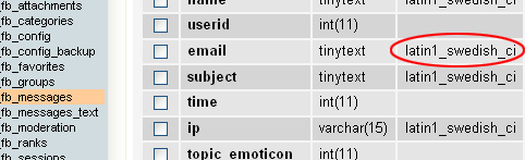

Deal all,
When installing Kunena 1.0.8 for the first time in my production site, I found that the collation for all my kunena in the database (e.g. xx_fb_announcement...) displayed as "latin1_swedish_ci", this caused me having problem to type in a foreign language like chinese. I have to change one by one the collation of kunena to "utf8_general_ci" so that it can support the language. Though I have reinstalled it many times, even to delete completely the kunena from the database and installed again, but the collation still be generated as "latin1_swedish_ci".
I have tested in another way, I installed kunena on a new copy of joomla and to my surprise, that this kunena's collation was installed as "utf8_general_ci" as I wanted. So, does anyone know what's problem in between? How can I resolve this problem on my production site instead of building all over again on the new joomla to avoid the problem. Thanks in advance.

Thanks! This phoca extension solved my problem completely. Thanks for sharing. Cheers!
