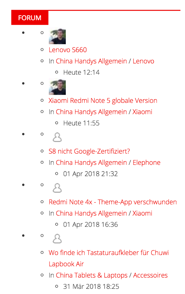

I just updated Kunena Latest Module and I noticed a problem.
When module's cache is ON (which is the default) css is ignored.
Module does NOT load the kunenalatest.css file, therefore module is not displayed correctly.
When module's cache is off everything is OK.

I can confirm this issue and here is the temp solution:
1. Create template override of kunena latest module
2. Copy kunenalatest.css into your template override you just created into foder: /templates/YOUR_TEMPLATE/html/mod_kunenalatest/css/
Now everything works at least on my end.
Hope this helps.

Can't confirm this. I am already running my module via an override, still looks screwed up when enabling cache.
8 years 7 months ago #199026 by 9themestore
If it does not work. I think, you can improve style in the template.css file of joomla template. If your site have been lived, paste the url here. We will help you check and solve this problem.
