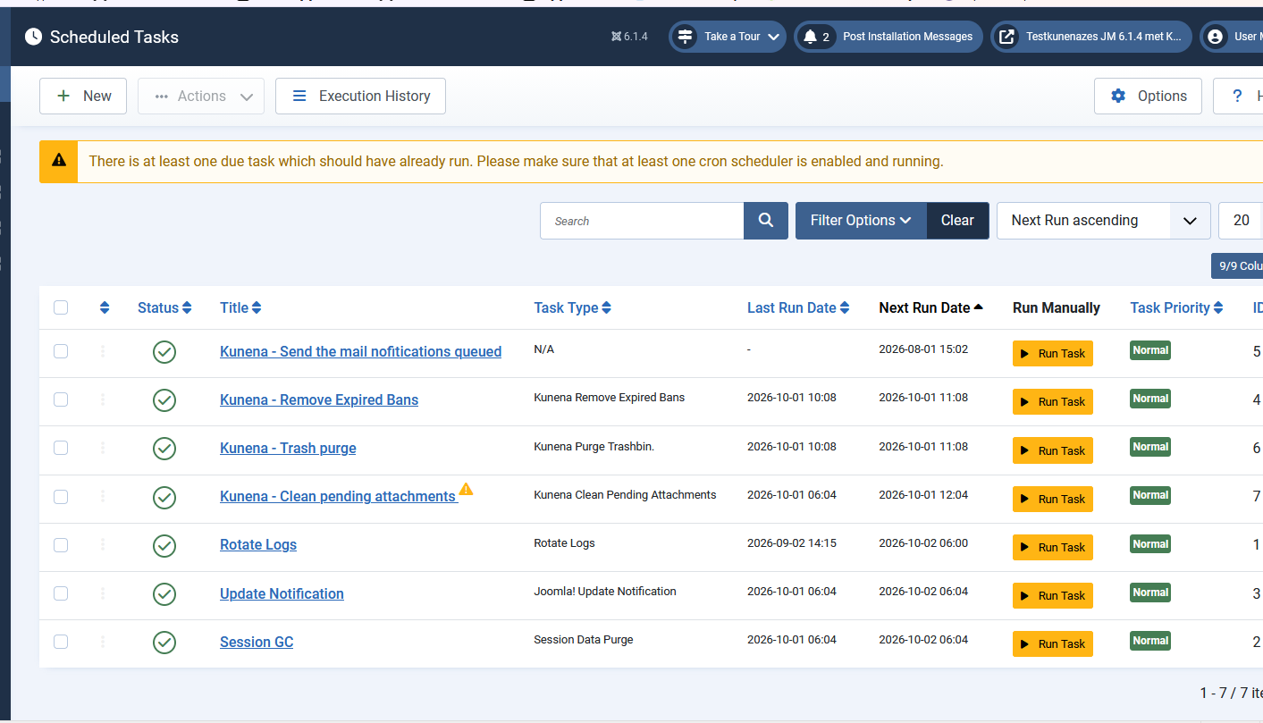

1 month 3 weeks ago - 1 month 3 weeks ago #235386 by Leen
I am using version 7.1.0-BETA4 (2026-09-29) in Joomla 6.1.4.
When I log in as an administrator, I receive an email with the following text:
Execution of scheduled task #7, "Kunena - Clean pending attachments," failed with exit code 5 on Thursday, October 1, 2026, at 06:04.
With kind regards
Leen

1 month 3 weeks ago - 1 month 3 weeks ago #235405 by xillibit
Enable logging and set a filename for log file, in the parameters of the task "Kunena - Clean pending attachments" :
And try a new time to launch the task
Last edit: 1 month 3 weeks ago by xillibit.
1 month 3 weeks ago #235407 by Leen
Okay, if I enter the filename there, I still get that little triangle with exit code 5, but the emails don't arrive.
However, this is on a live hosting site.
If I run the same site on WampServer, I don't get that triangle,
and I don't get any notification emails either,
so it might be something to do with my settings at the Vimexx host I'll compare them further.
With kind regards
Leen
1 month 3 weeks ago #235408 by xillibit
The task which got an error is the cleaning attachment, on your screenshot there is nothing on the send mails notififications.
Do-you have looked in backend under Kunena -> mailsqueues to see if there are entries ? And what are the status of them ?
