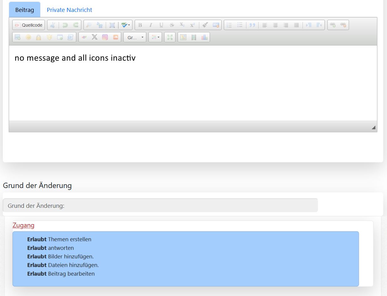

hi,
I setup a new Joomla site with a fresh Kunena 7.0.2.
as this should be an update to an old J3 website I saved all Kunena db entries, updated them to the K7 schema and imported ALL
to the new installation.
everything works fine - instead of on error.
when I'm logged in as superuser I can edit or quote each message BUT NOT the first one of a topic.
(the new sample message of the kunena 7 install I can edit)
the CKeditor is opened, but no message appears and the browser console gives me this error:
Uncaught TypeError: can't access property "type", g is null
    onTagClose /media/kunena/core/js/ckeditor.js?aa68f1:1298
    parse /media/kunena/core/js/ckeditor.js?aa68f1:1295
    fromBBCode /media/kunena/core/js/ckeditor.js?aa68f1:1299
    b /media/kunena/core/js/ckeditor.js?aa68f1:1303
    l /media/kunena/core/js/ckeditor.js?aa68f1:10
   and many, many more
I rerun the installation and during the db import I checked this after each single import,
but the import of categories, topics and messages must be present to open an old topic to check for this error.
in the moment I have not yet importet the kunena user tables, but on the installation before it was complete.
I don't know how the kunena script works on edit or reply and what rights or settings are checked during script run
may be some of you knows what is running in the background and can help me please to find if/where I must change
something. (in the db tables)
as far as I see every all other functions work.
btw.  switching to private message the editor works fine

In the moment I found out this:
1.  SCEditor   is working fine  (so the db import looks without errors)
2. in CKEditor  the original message is loaded and present  in the hidden textarea (as it should be)
so there must be some js problem within loading ckeditor  (Uncaught TypeError: can't access property "type", g is null)
as written: when switching to private message ckeditor enables all buttons
thanks

7 months 2 weeks ago - 7 months 2 weeks ago #234904 by joomod
thank you
Could be a javascript which is corrupted or could be an issue with the language file for Ckeditor which is a javascript file
the most confusing thing is, that CK Editor works well on all messages #2 and up of a topic,  but NOT on the first (opening) message.
(also as written, SK Editor works on ALL)
so what I'm interested in, from the kunena insiders, if there is some db setting in this new versions 6-7 for the opening (first) message,
which I may have missed during my import  (also because CK Editor works on the first message of the new created kunena 'welcome' message.
so what is the difference on calling the CK Editor on the top, first message  against loading on a following message?
as there are no problems on higher messages the JS files seems to be ok, but as all are minified it is hard to read
thank you
EDIT:
I found out some more details:
it is not the first or second or somthing message, it depends on images.
(as mostly in the first message there are images, I thought just of the first as reason)
it only happens (or better does not :)) if the image is inline, which means included by using a link with the URL tag,
images included as attachment are no problems.
so CK Editor must have a problem with images included the "old way" not using attachment
any ideas ???
