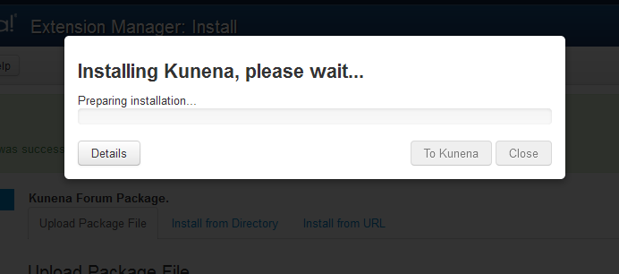

Let me jump in here with the exact same issue.
System specs are Joomla 3.1 beta 4 and Kunena 3.0 beta 2. The installation hangs as shown on the screenshot and Firebug gives me the following error:
TypeError: window.parent.SqueezeBox.asset is undefined
http://.../media/jui/js/jquery.min.js/eval/seq/1
Line 18
If there is anything I can do to help solve this let me know.
Edit: I have Kunena now installed by doing the following.
In the file install\tmpl\default.php I commented out the line
as it seems that SqueezeBox doesn't have an asset method.
After that I installed the package, this doesn't bring up the usual popup for the installation.
Finally I navigated to administrator/index.php?option=com_kunena and this started the installation and finished as expected. All seems to be working fine
Line 18
//window.parent.SqueezeBox.asset.set('scrolling', 'no');
