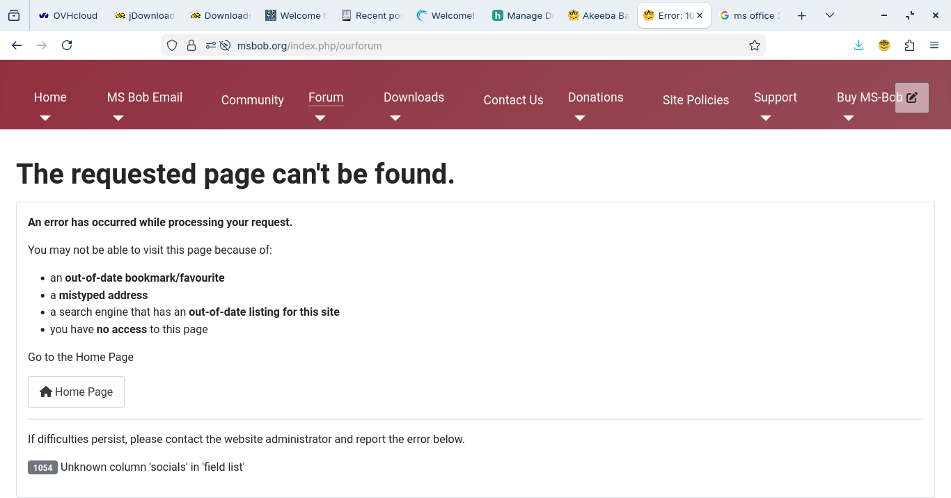

If you go to the forum while a guest you can see it fine, but if you are logged in you get this.
Any suggestions?

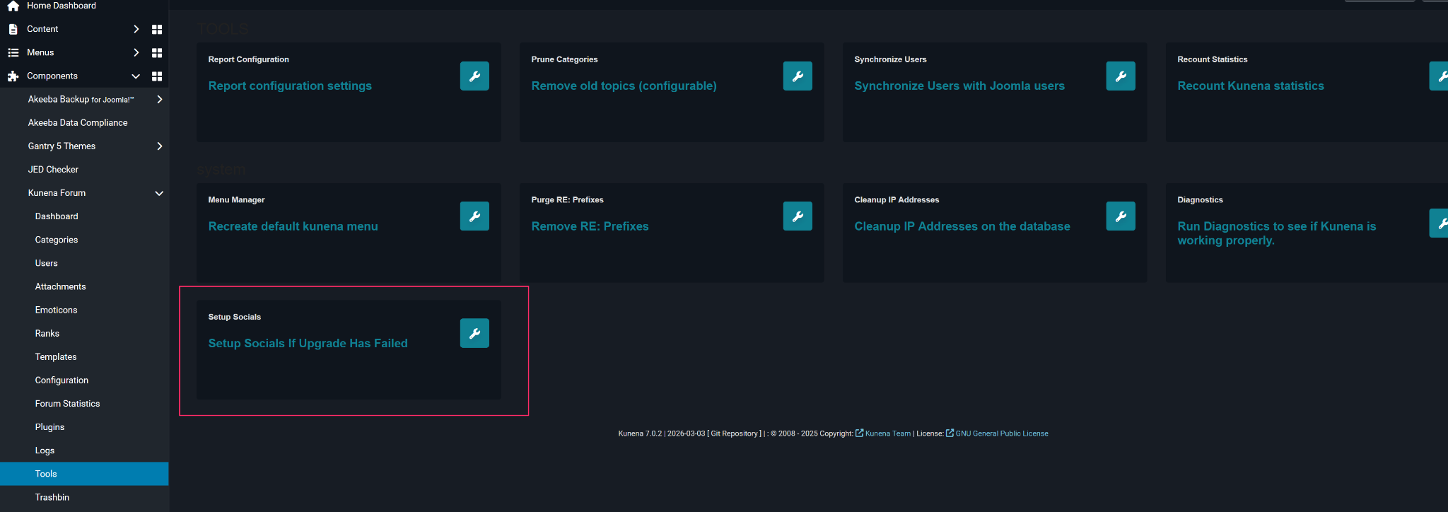

There are a tool added in Kunena 7.0.2 to fix this issue, make a backup of your table #__kunena_users just in case, you will find it under Tools :
open the Setup Socials If Upgrade Has Failed then it will do itself the fixex on the database
The following user(s) said Thank You: fstltna
