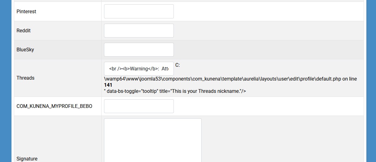

1 year 5 months ago #233043 by Pinkeltje
Correct and can reproduce now as well on this forum. It has something to do with the threads entry in profile. When enabling debug en error reporting it shows:
Warning: Attempt to read property "value" on string in D:\xampp\htdocs\5\components\com_kunena\template\aurelia\layouts\user\edit\profile\default.php on line 141
<td>                 <input class="form-control hasTooltip" id="socialthreads" type="text" maxlength="100" name="socialthreads" value="<br /> <font size='1'><table class='xdebug-error xe-warning' dir='ltr' border='1' cellspacing='0' cellpadding='1'> <tr><th align='left' bgcolor='#f57900' colspan=" 5"=""></td>

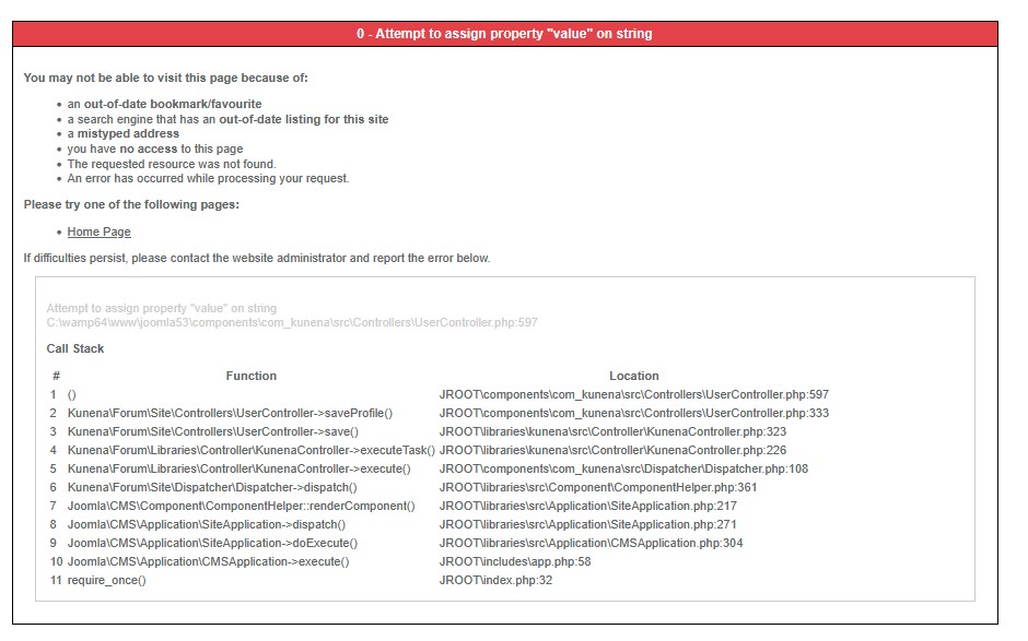

1 year 5 months ago - 1 year 5 months ago #233073 by Leen
Thank you
i tried it on a local test site that gave all that message and it keeps coming
0 - Attempt to assign property "value" on string[b]You may not be able to visit this page because of:[/b]
  • Code:
    an [b]out-of-date bookmark/favourite[/b]
    • Code:
      a search engine that has an [b]out-of-date listing for this site[/b]
      • Code:
        a [b]mistyped address[/b]
        • Code:
          you have [b]no access[/b] to this page
          • Code:
            The requested resource was not found.
            • Code:
              An error has occurred while processing your request.
[b]Please try one of the following pages:[/b]
  • Code:
    [url=http://localhost/joomla53/index.php]Home Page[/url]
If difficulties persist, please contact the website administrator and report the error below.Attempt to assign property "value" on string C:\wamp64\www\joomla53\components\com_kunena\src\Controllers\UserController.php:597Call Stack[b]#[/b][b]Function[/b][b]Location[/b]1()JROOT\components\com_kunena\src\Controllers\UserController.php:5972Kunena\Forum\Site\Controllers\UserController->saveProfile()JROOT\components\com_kunena\src\Controllers\UserController.php:3333Kunena\Forum\Site\Controllers\UserController->save()JROOT\libraries\kunena\src\Controller\KunenaController.php:3234Kunena\Forum\Libraries\Controller\KunenaController->executeTask()JROOT\libraries\kunena\src\Controller\KunenaController.php:2265Kunena\Forum\Libraries\Controller\KunenaController->execute()JROOT\components\com_kunena\src\Dispatcher\Dispatcher.php:1086Kunena\Forum\Site\Dispatcher\Dispatcher->dispatch()JROOT\libraries\src\Component\ComponentHelper.php:3617Joomla\CMS\Component\ComponentHelper::renderComponent()JROOT\libraries\src\Application\SiteApplication.php:2178Joomla\CMS\Application\SiteApplication->dispatch()JROOT\libraries\src\Application\SiteApplication.php:2719Joomla\CMS\Application\SiteApplication->doExecute()JROOT\libraries\src\Application\CMSApplication.php:30410Joomla\CMS\Application\CMSApplication->execute()JROOT\includes\app.php:5811require_once()JROOT\index.php:32
