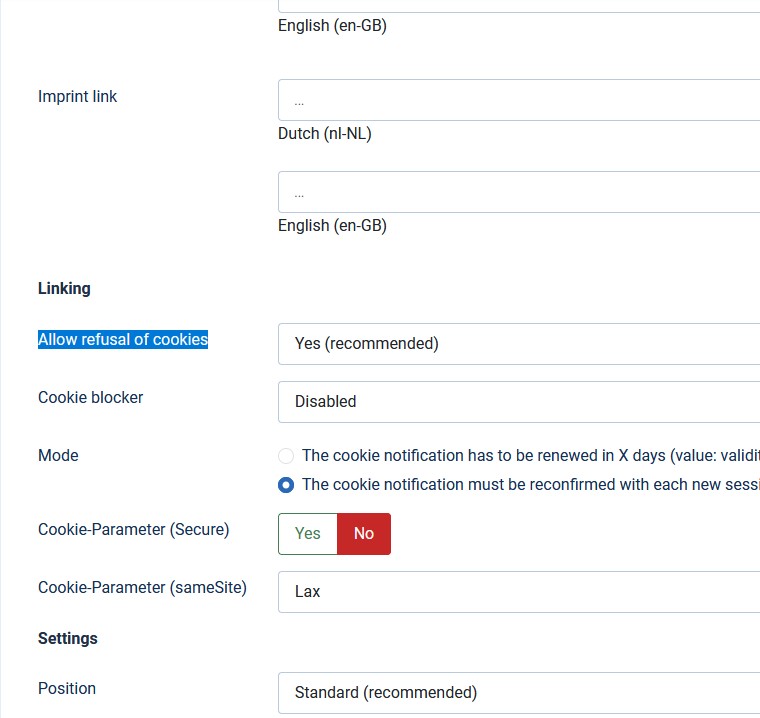

1 year 7 months ago #233236 by Leen
You can also check whether the plugin cookie hint has various settings, such as Allow refusal of cookies (set to yes).
With kind regards
Leen
