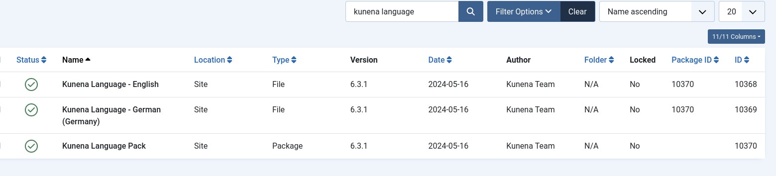

2 years 5 months ago #231516 by Goldie
Replied by Goldie on topic no editor showing
I had even deinstalled and reinstalled Kunena Language Pack. Have a look here:
First you tell me "active" is not possible and I should check my Joomla installation. Now I shall have outdated Kunena language files.
You are the expert. How shall I correct it?
