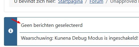

The kcheck checkbox on the Unapproved Posts page has a name of posts[nnnn], however the TopicsController is expecting this name to be topics[nnnn]. The name is correct when viewing the category list and the topic can be approved from this list. When attempting to approve from the Unapproved Posts page the TopicsController always returns No Message Selected.

i can confirm this
. I have to open the topic and then approve the message there.
then it will work
then it will work

Thanks for the report and the check, i was able to reproduce it so i have just made a fix for it : github.com/Kunena/Kunena-Forum/commit/ec...cce8096fd5037375b3e4

I tried this fix and it works
