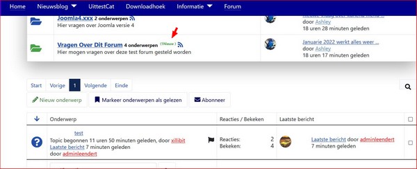

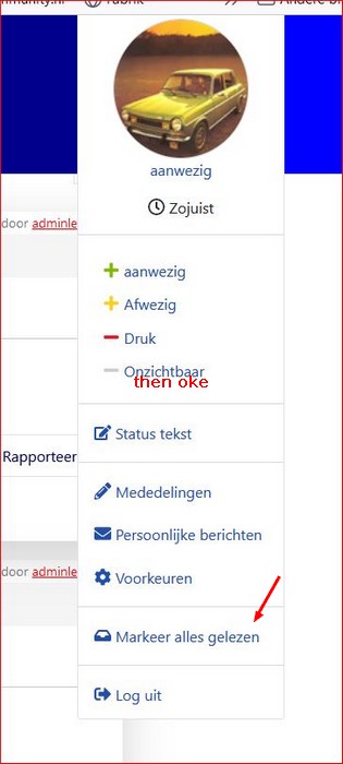

Replied by Leen on topic The Action button for respond or quite or edit gives Error
now very special when I log in at the kunena screen clicks mark all read then
I can suddenly open the message with admin again etc
I couldn't find any differences between settings Ashley(Registered person) and adminleen(superuser)
ps
maybe that will help you too so you can read and edit messages
ps

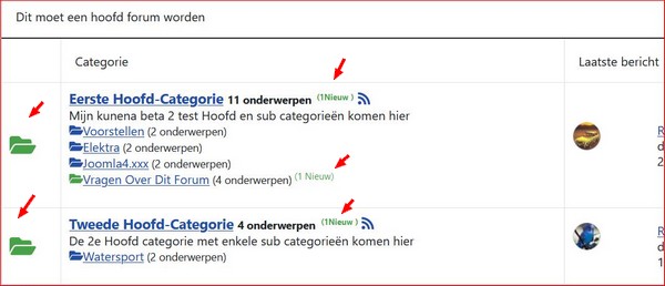

4 years 7 months ago - 4 years 7 months ago #221619
by Leen
With kind regards
Leen
I edited this this morning for the test live site. so i can try to see if problem is gone
It works now
The only thing that strikes me is that when I've read them the message that there is a new message is not cleared.
Not even if I select everything and then click the read all button.
I can do that separately with a registered user then is gone
but as administrator it stay
It works now
