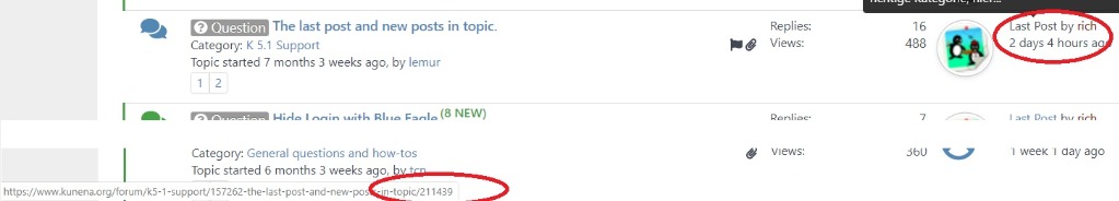

But I just noticed that on your website
www.kunena.org/forum/recent
the "Last Post" button works just as wrong as on my Russian site !?.
More precisely, it happens in the Chrome browser.
I checked what is going on in the Firefox browser. Everything works fine in it!

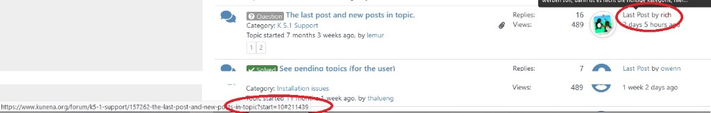

URLs for Last Post in these browsers are formed in different ways. For example, for this topic
In chrome:
www.kunena.org/forum/k5-1-support/157262...osts-in-topic/211439
In Firefox:
www.kunena.org/forum/k5-1-support/157262...opic?start=10#211439
