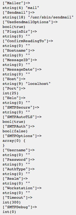

encountered the same issue and can give you some insights.
First my temporary workaround so that the emails are sent again:
\KunenaEmail::send (libraries/kunena/email/email.php)
foreach ($chunks as $emails) { try { \Joomla\CMS\Factory::getMailer()->sendMail(\Joomla\CMS\Factory::getApplication()->get('mailfrom'), \Joomla\CMS\Factory::getApplication()->get('fromname'), $emails, $mail->Subject, $mail->Body, true); } catch (Exception $e) { $success = false; \Joomla\CMS\Log\Log::add($e->getMessage(), \Joomla\CMS\Log\Log::ERROR, 'kunena'); } }
Attention: For me this is sufficient because I'm the only notification receiver and don't need to hide email addresses in BCC etc.
The problem is that you don't set the proper default mailer in the current Kunena code. I use SMTP but if you check the object that was created by Kunena, you see that the SMTP data is not set properly (in fact the mailer is set to "mail" which does not work on my server due to security settings):
You need to specify the SMTP values explicitly, this is how it is done in the Factory class correctly and thus my workaround works as expected. Just take a look into this function \Joomla\CMS\Factory::createMailer (libraries/src/Factory.php).
My suggestion: Either use \Joomla\CMS\Factory::getMailer() or set the mailer properly.
Have success!

8 years 4 months ago #202690 by 810
Replied by 810 on topic Problem with email
@fiat4x4.gr could you test the nightly build. Its should be ok now.

8 years 3 months ago #203953 by fiat4x4.gr
Replied by fiat4x4.gr on topic Problem with email
Kunena 5.1.3 Dione solved the problem!
