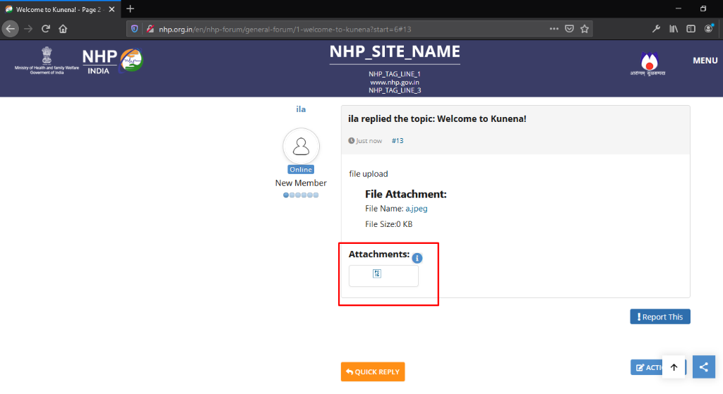

An attacker can upload malicious executable files on the system by simply renaming .exe file to .jpeg and the kunena forum allows it to upload even if the mime type check is active and the .exe extension is added to not allowed list.
It should do proper checks on Content type as well. This is a high risk vulnerability!
I'm using version 5.0.14 and we cannot give it to client till it is fixed. Please help me to put this code manually. Images are attached below.

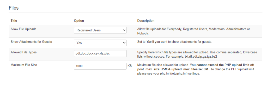

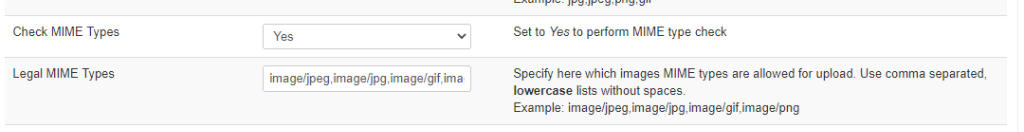

We have kunena forum installed on our website nhp.org.in and the mime type check is active in the configuration (ref, attachments) but it is not working as it is possible to upload any exe file file by renaming it to jpeg/pdf or any allowed mime type (even malware file!)
As you can see in attachments I have enabled the mime type check but it still allows exe file to be uploaded when renamed.

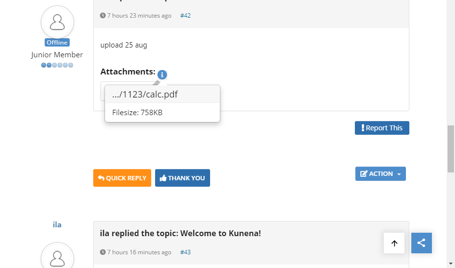

If we view attachments page of the forum it clearly identifies the type as application/x-dosexec but still allows it to upload.
This is a security risk. Please help us fix this in our current version of Kenena
