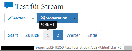

Thank you for the quick response - I have tested the nightly (K 1.5.16 - 20200311) and still have the same error.
When I thank someone for a post, the link shown in the activity stream is forum/test2/19350-test-fuer-stream/22379.html
This messes up the navigation (see image attached) and I would think this is a bug:
Additionally, if a new post is added, the link in the stream always brings me to the first post of the topic (forum/test2/19350-test-fuer-stream.html), whereas I would expect to directly see the referenced post. (feature request)
However, the Kunena Latest module works perfectly fine: forum/test2/19350-test-fuer-stream.html?start=10#22380
Best regards
