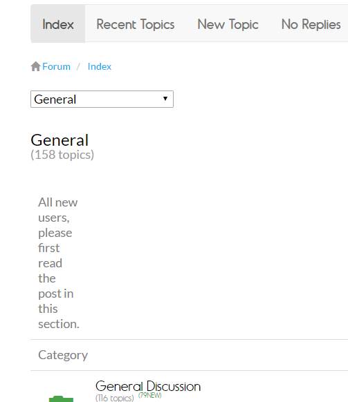

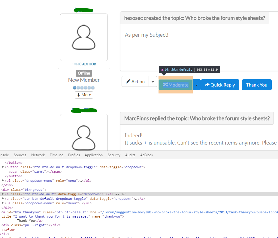

Dear Devs,
I have joomla 3.6.2 and Kunena 5.0.1. The template that I'm currently using is Crypsisb3.
I'm experiencing problem in the frontend because the forum buttons are misaligned and they seems to be anchor more than buttons.
In fact when I change the html code of the buttons from tag <a> to tag <button> everything looks fine and better.
Please see the attached screenshot.
How can I fix it?
Thanks a lot for your help,
kind regards
Filippo
Last edit: 10 years 2 months ago by emutex. Reason: attaches missing

10 years 2 months ago #179293 by 810
your template has not all css classes.
If you want to change to button, you need to change this file. components\com_kunena\template\crypsisb3\layouts\widget\button\default.php
