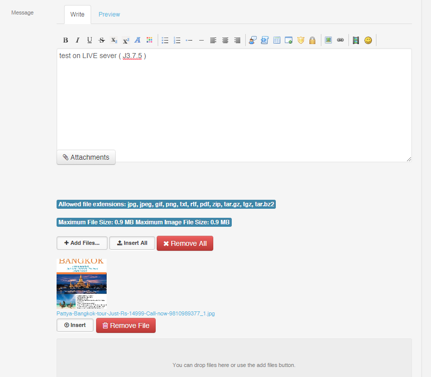

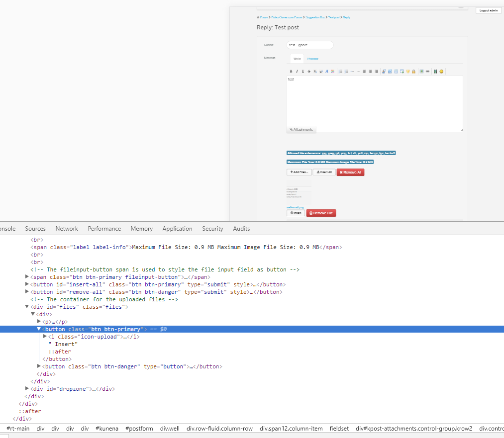

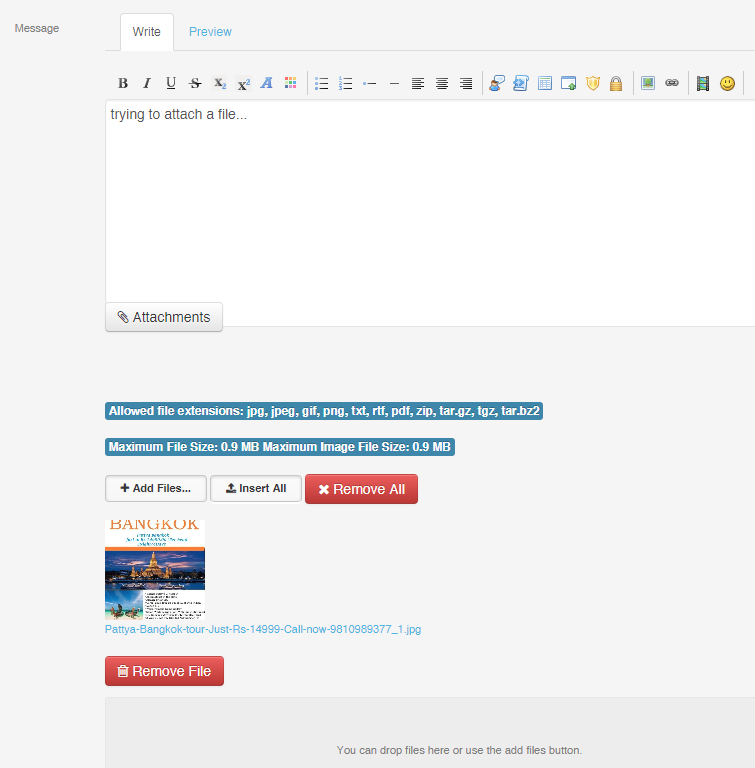

But when I clone the installation and try upgrading it to Joomla 3.8.2 ( on DEV server) everything "appears" perfectly fine, but when testing Kunena I cannot attach files in any posting. They seem to UPLOAD OK ( I can see them in the TMP folder) but aside from seeing the thumbnail(s) at the bottom of the post, there is no way to attach them, nor to insert them into post as IMG. There is an INSERT ALL button but it doesn't do anything. No longer an "INSERT" button for each image...
Any hints??? see pics below
This is after upgrade to Joomla 3.8.2:
this is Joomla 3.7.5:

Working ( live server)

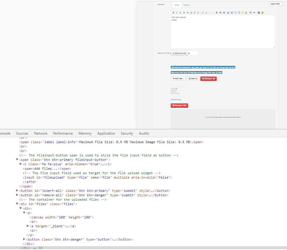

and...
NOT working ( dev server)
Both servers running same PHP7.1u (latest)
