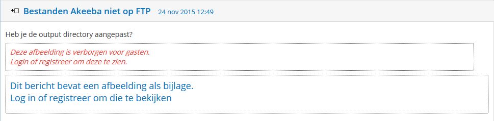

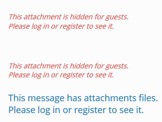

11 years 1 month ago #169091 by Pinkeltje
When applying this setting:
And same for files, a duplicate warning appears in topic when user is not logged in:

Hi Pinkeltje,
I don't know why the Kunena team has chosen to display multiple messages? If you would ask me, i should say it should be enough if there is only one notification. (Let's say the blue one, but hey that is my and probably a different kind of logic)
The red colored notifications, where generated when there should be a attached image displayed by the BB tags. So in this case you should be looking in the file /libraries/kunena/bbcode/bbcode.php, there is a method/function there called renderAttachment on line 2212, you could replace it with the following:
protected function renderAttachment(KunenaAttachment $attachment, $bbcode, $displayImage = true) { $layout = KunenaLayout::factory('BBCode/Attachment') ->set('attachment', $attachment) ->set('canLink', $bbcode->autolink_disable == 0); $config = KunenaConfig::getInstance(); if (!$attachment->exists() || !$attachment->getPath()) { return (string) $layout->setLayout('deleted'); } elseif (!$attachment->isAuthorised() && !$config->showimgforguest) { return null; } elseif (!$attachment->isAuthorised()) { return (string) $layout->setLayout('unauthorised'); } $bbcode->parent->inline_attachments[$attachment->id] = $attachment; if ($displayImage && $attachment->isImage()) { $layout->setLayout('image'); } return (string) $layout; }
Basically i just added a condition, you should get the same the same if you replace the return null within this condition:
(But just to be safe i added a additional condition, since i don't know when the isAutorised method is false ;) )

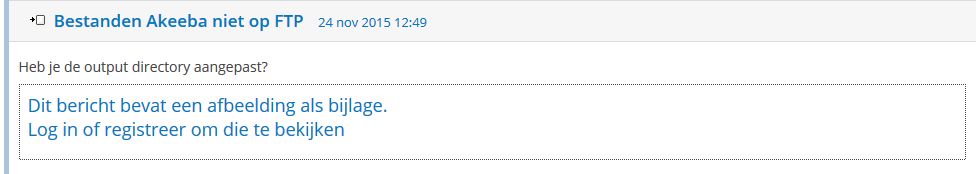

11 years 14 minutes ago - 11 years 13 minutes ago #170662 by Pinkeltje
As already mentionned in my first post: showing a message is ok, but there is no need to show a duplicate message.
Old situation:
After applying changes made by Juliank92:
Display for logged-in users (in both situations):
