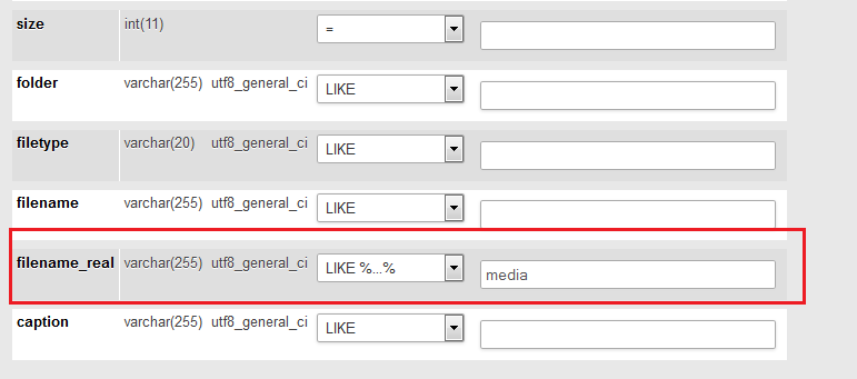

This is my workaround; it's a bit technical:
1. Make a backup. We have to modify some database fields, so the entire site could break.
2. Using phpmyadmin (or similar) go to kunena_attachments table.
3. Search something relevant of your path (for example, media) in the filename_real field:
4. Results are the attachments with full path. Just edit each one deleting the full path and keeping the file name.
For example, in your case you should have an entry with media/kunena/attachments/Dienstleistungskatalog_eines_Versicherungsbrokers.pdf/Dienstleistungskatalog_eines_Versicherungsbrokers.pdf and after editing you should have only Dienstleistungskatalog_eines_Versicherungsbrokers.pdf

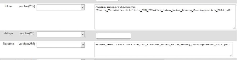

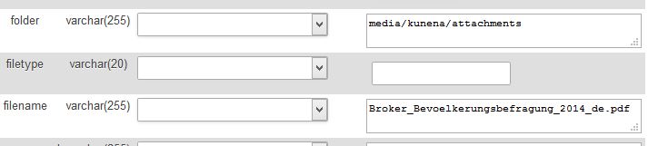

Hello Jose
Thanks for your solution, but is not exactly like this.
I made to printscreens from a wrong and a correct entry.
The "folder" entry is not correct...
OLD: /media/kunena/attachments/documentname.pdf
Correct: media/kunena/attachments
Maybe i can make a database replace from all entries with ".pdf" to /media/kunena/attachments :unsure:
i will try this :silly:
Thank you for your help
Corinne
