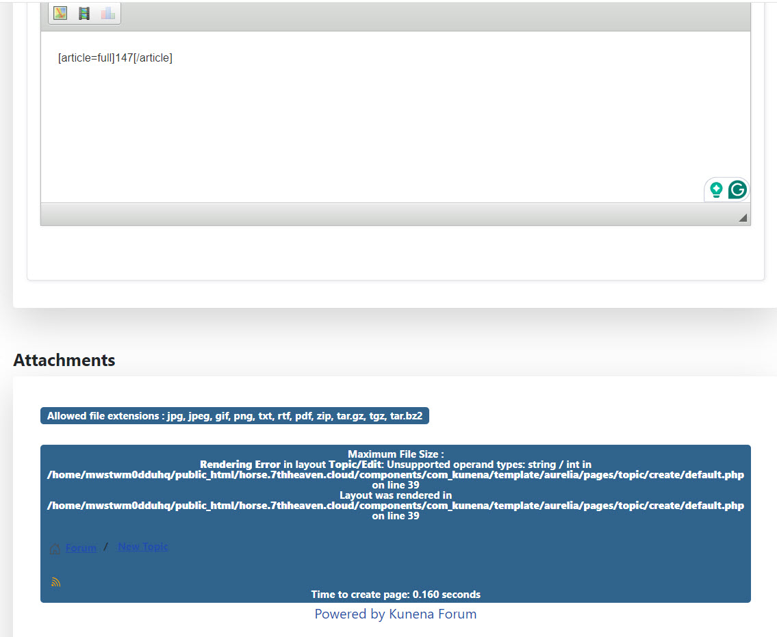

I'm getting the following errore while trying to add a topic;
Rendering Error in layout Topic/Edit: Unsupported operand types: string / int. Please enable debug mode for more information.
How do I "enable debug mode"?

Hello,You are trying to upload an attachment (file or image) which exceeds the limit of the settings from the Kunena configuration. It shouldn’t display an error like that but just an error message. You need too enable the debug mode into Kunena configuration, if you re-try i twill show you more details on the error. And please make a new screenshot and add into your message which helps to found the issue.

Can reproduce the error when Maximum Image File Size and/or Maximum File Size are empty.
