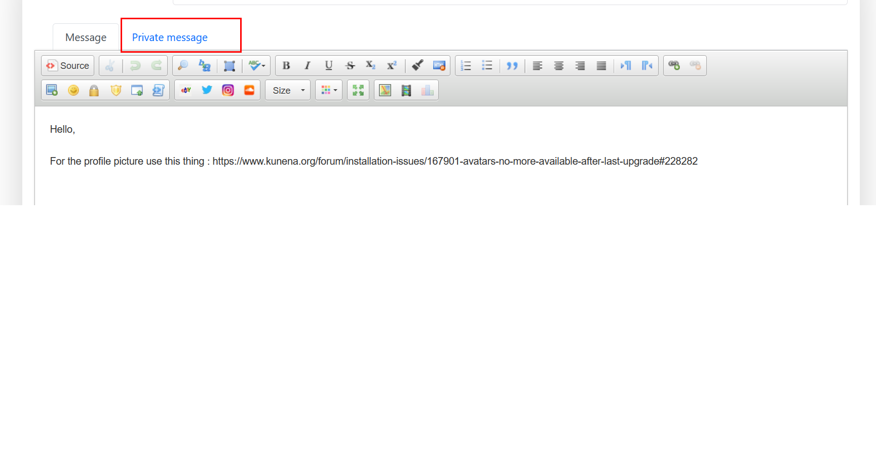

For the private messages it's located here :

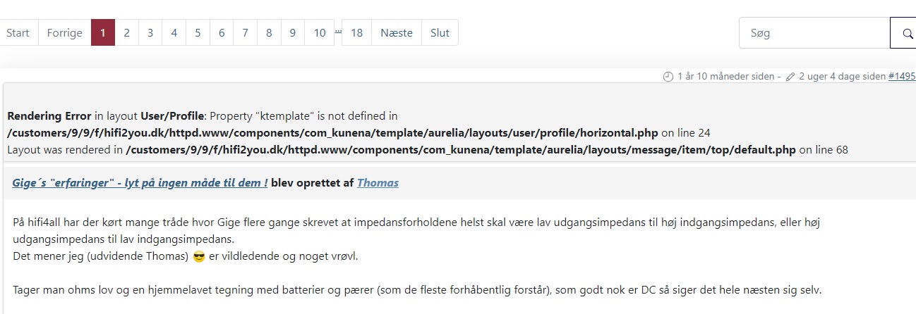

I have tried to make an error rapport and maked a screenshot of the error in the topic (Debug mode)
I still get a blank site.

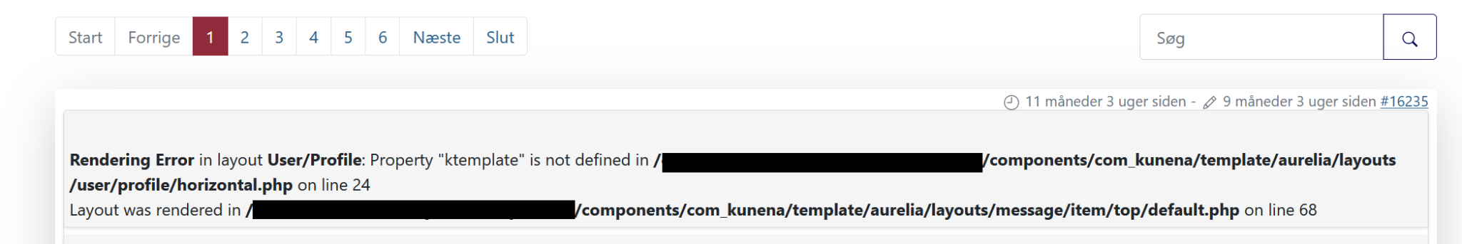

It's not what i had asked, i have lokked directly on your site i can see this error message on a topic :
