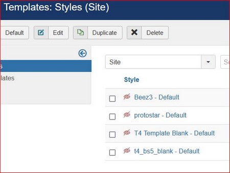

Then installed Helix3 Template Framework => buttons in Forum have no more any functions.
Then installed Helix Ultimate => buttons not working (I know it cannot work because it is bootstrap5)
Then I installed T4 Template framework => blank page on trying to create new post or edit a post.
Any idea what to get these funktions working again?

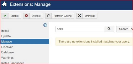

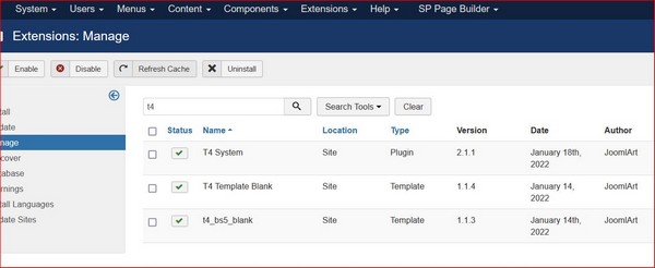

i have a test site running joomla 3 and kunena 5.2.8 and Crypsisb4
with www.joomlart.com/member/downloads/joomlart/t4/t4-framework .
But only works if you neatly remove everything from Helix via Extensions: Then manage search on helix..

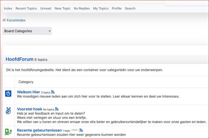

Replied by Maago on topic Kunena issues with Template Frameworks

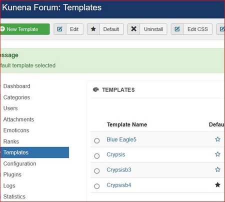

I removed everything from Helix3, set site template to T4 and set Kunena template to crypsis4 ..
I can call the forum, can open all posts, but once I try to edit a post or create a new post => blank page appears.

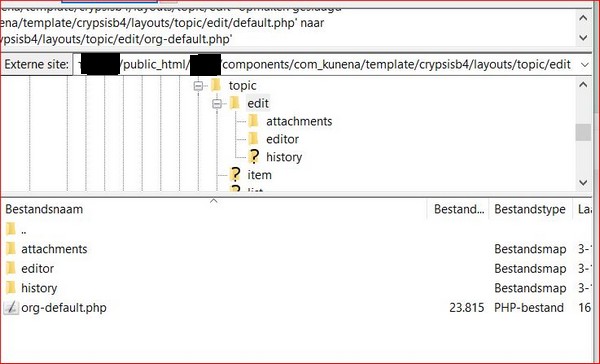

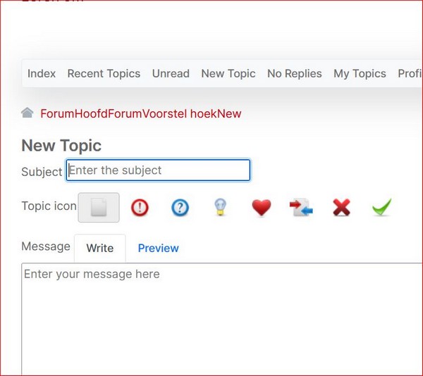

Replied by Leen on topic Kunena issues with Template Frameworks
I have that blank image when making a new topic
I think found
give the default.php new name there eg org-default.php then you can create a new topic.
I will further investigate the action button and quick replay
I think found
dewebsite/components/com_kunena/template/crypsisb4/layouts/topic/edit
With kind regards
Leen
