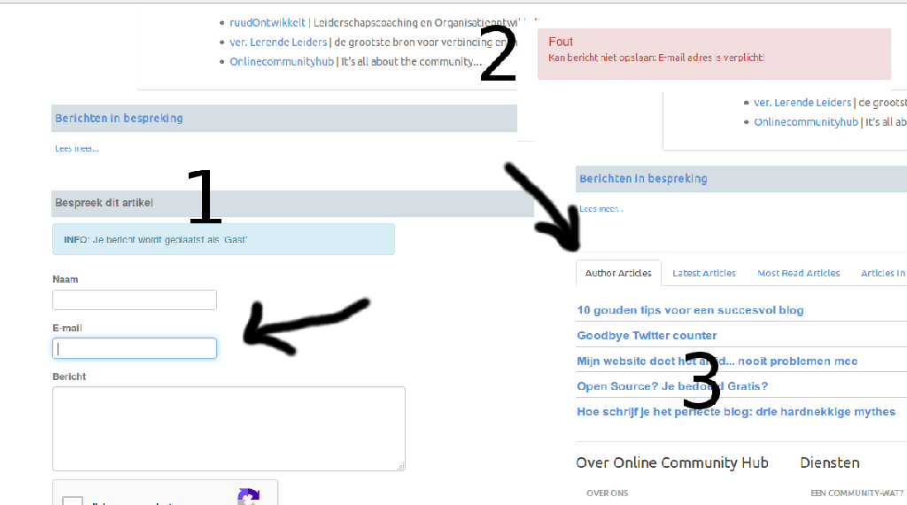

a user pointed me to the following:
1. When entering a comment to a blog via Kunena Discuss, the required email field = blue (see 1 in attached screencapture).
this means that the field is not required
2. when posting without email address, the joomla message is generated correct and displayed (which is correct because in the back-end the email address is required) (see 2 in attached screencapture)
but...
when scrolling down to repost the comment, the form to input the comment is NOT showing (see 3 in attached screencapture)
This is not helping generating more comments and interaction :)
So basically two things:
1. email field not red when required
2. input form disappearing

just fixed the field not being required: PR is here
With this fix in place, the browser checks before submitting the form so the trouble where the form disappears is not encounted (note, not fixed, but the guest will never get to that point)
