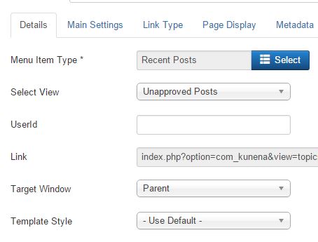

Create the Kunena menu item type Recent Posts and Select View = Unapproved Posts. This menu item shows all unapproved posts.
Or use the search option. Click on the search button, mark the option "Show Unapproved Posts" and in the keyword field put only a star. * Then click on search. All unapproved posts should be found (if there are any).

rich wrote: Create the Kunena menu item type Recent Posts and Select View = Unapproved Posts. This menu item shows all unapproved posts.
This is exactly how I have it, and it does not work

hm.. you use Blue Eagle? I've tested it now and you're right. This menu item not working as expected. But this problem exists only with Blue Eagle and not with Crypsis. I will create a bug report.

10 years 8 months ago #171268 by 810
yes, you need to enter * under userid, then you see all messages that are under review.
