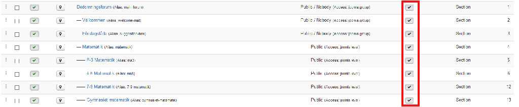

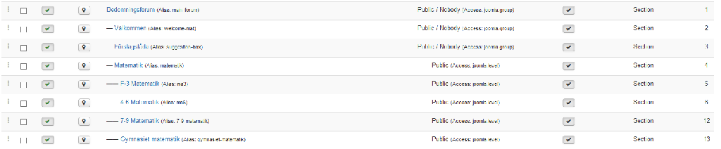

For some reason all of my categories are sections, see attached image.

Anyone who has an idea why my categories suddenly turns to catogories? The categories lies under a section and should therefore be a category, or have I misunderstod something.
10 years 11 months ago #170680 by rich
Replied by rich on topic Can't start a new topic
You have all empty categories locked? In this topic, you will find the answer.

10 years 11 months ago #170684 by rich
Click on all hook, then it should work again. A hook means the category is locked.
