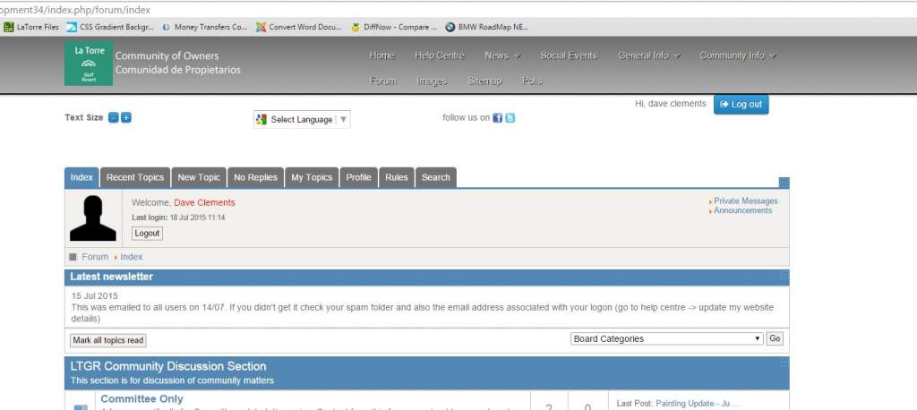

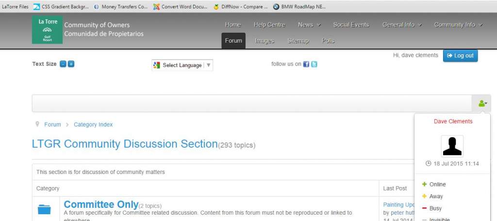

The blue eagle template seems ok but crypsis has an empty menu bar. is this a bug or an incompatibility. My website template is the Gantry framework

My website has a main menu with one item for the “forum” that links to the forum home page.
There is also a separate Joomla Menu “Kunena” that contains all the other Kunena options (e.g. my topics, rules, help etc.).
It appears that Blue Eagle will pick the items up from the Kunena menu, whereas Crypsis only looks in the Joomla main menu
If I add a sub menu item such as “my topics” to my “forum” main Joomla menu item then the forum menu bar contains it.
Finally I changed the definition of the main website forum menu item. Instead of it being type "kunena home page" I made the menu item an alias of the kunena menu. This seems to have solved the problem.
So maybe not a bug but definitely a different behaviour to the blue eagle template
