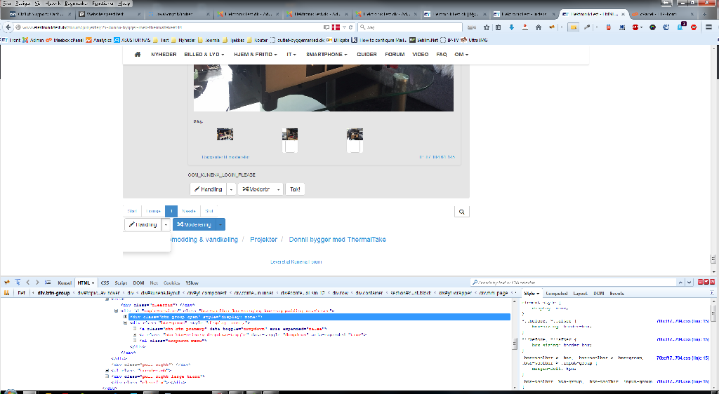

When clicking on the "Moderate" or "Handling" or almost any other button, they disappear.
Also, the "white" box under the thumbnails looks weird, and after hovering over this box and moving the cursor, the box disappears.
And the dropdown under the "Handling" button is way off to the left, as seen on the screenshot.
Another thing is that when pressing an image, to open it in a modal window, it takes quite a long time before it opens.
And at last, when clicking the "profile button", the one on the right in the menu, it doesn't open op the dropdown menu, before you move the cursor, and besides that, the status modal doesn't work either.

looks like a jquery conflict. With multiple versions running at once.
try to delete components / com_kunena / template / crypsis / template.php line 95:
JHtml::_('jquery.framework');
And try again.
