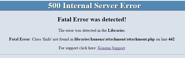

11 years 5 months ago #164593 by ssh
Sure.
Here is the exact error after enable debug mode:
11 years 5 months ago #164613 by xillibit
You need to have fileinfo extension enabled in php extensions, are-you on wamp or something similar ?
The following user(s) said Thank You: ssh
11 years 5 months ago #164616 by ssh
No. I am running VPS LAMP w/cpanel
I notice that I do not have fileinfo support enabled, In that case, I am going to install it and let you know ASAP.
11 years 5 months ago - 11 years 5 months ago #164625 by ssh
version 1.0.5
It is working ok now.
Last edit: 11 years 5 months ago by ssh.
11 years 5 months ago #164636 by ssh
Thanks you so much all of you for your support.
Please close this topic as SOLVED
