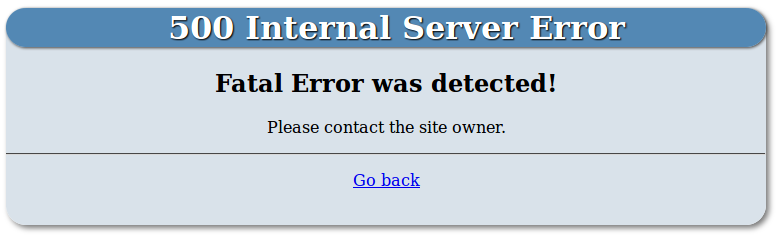

Hi, when using Kunena with Blue Eagle template on my site with meet_gavern template Kunena displays correct.
When switching to Crypsis template I directly get 500 error (switching to Protostar template is a work-around). Is probably a template related issue but since there is no message other then the one displayed below it is a little bit hard to troubleshoot.

11 years 6 months ago #163404 by xillibit
Replied by xillibit on topic Server error 500
You need to enable debug mode into Kunena configuration and Joomla! configuration panel to see a more better error message. And try when you are logged as adminsitrator
11 years 6 months ago #163416 by ruud
Replied by ruud on topic Server error 500
Okay, here goes:
500 Internal Server Error
Fatal Error was detected!
The error was detected in the Meet Gavern Template.
Fatal Error: Cannot redeclare class lessc in templates/meet_gavern/lib/framework/lessparser.php on line 40
sharing = caring
11 years 6 months ago #163420 by xillibit
In the past we had encountered the issue : github.com/GavickPro/Meet-Gavern/issues/59 but i don't know if in meet gavern template they have changed something since this time, is-this the last version of meet gavern that you are using ?
11 years 6 months ago #163425 by ruud
Thanks,
just 'patched' two meet_gavern files where I made the loading of the lessparser.php conditional
it now works.
Version of meet_gavern is latest version, will create a pull request for my changes to the meet_gavern repo on git. Let's see what they think about it :)
sharing = caring
11 years 6 months ago #163426 by xillibit
it's good if you can do that :)
