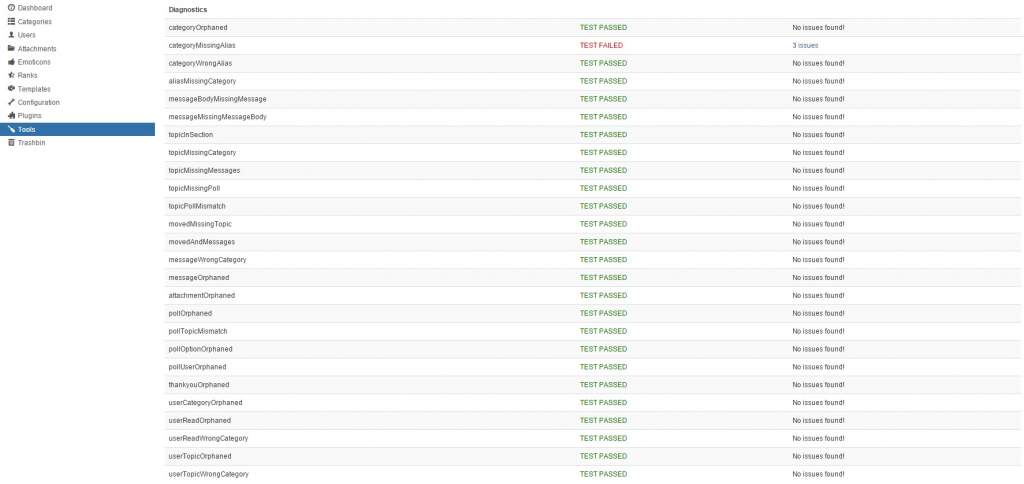

10 years 9 months ago #172566 by dimov
Thank you for answer.
I try this page in my new joomla 3.4 site and have this errors:
But when I click on this 3 issues there is nothing happened.
How can I fix this?
10 years 9 months ago - 10 years 9 months ago #172567 by dimov
Ok, I found there was 3 categories without aliases.
I add aliases to this 3 categories and now all test are passed with this checking configuration, but I still have the same problem:
Can't make new topis, can't answer too.
Do you have any other idea about this?
