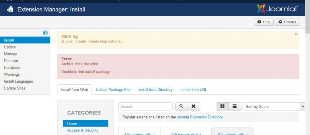

I'm having some trouble upgrading Kunena 3.0.8 to the latest version 4.0.1.
When using the "Install from Web" option in Joomla 3.4.1, the 'whirly' joomla icon rotates for a few seconds and then I get the following errors...
Yellow box: "Warning. JFolder::create: Infinite loop detected"
Red box: "Error. Archive does not exist. Unable to find install package"
Screenshot...

10 years 10 months ago #166460 by Socratic
Thanks for your help xillibit, but sadly that wasn't the problem in this case (although you did somewhat accidentally lead me to the answer - cheers)!
Luckily, it turns out that thanks to the fact that a couple of folders remained "unwritable" in Joomla's eyes no matter what I did to their permissions, I discovered that while I had recently changed the webspace's account name in that server's Plesk control panel (which had automatically altered the directory structure accordingly), I hadn't changed the paths of the Joomla "tmp" and "logs" folders in Joomla's "Global Configuration" page (those Joomla paths were still pointing to the old linux path that no longer existed). That was the cause of the failure. As soon as I updated these paths to the correct locations, the installation worked fine and I now have Kunena v4!!
