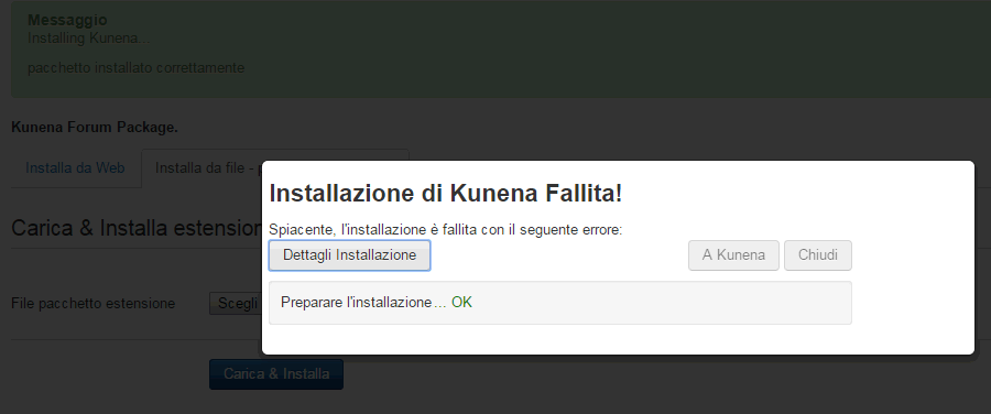

I'm trying to install a fresh Kunena 4.0 version on Joomla 3.4.1 site.
MySQL server is 5.6.23 and PHP 5.4.41.
After few seconds the installation returns the attached error.
I tried to uninstall and install 3.0.8 version directly from Joomla component installatiom but I received the same error.
What is the problem?
Please, help me.

11 years 4 months ago #165473 by marcozeus
After installation fail error, I can see the Kunena administration menu.
I clicked on it and the system try to complete the installation but a new error appears:
:huh:
Please, help me
11 years 4 months ago #165474 by marcozeus
:ohmy:
I disabled Kunena - Joomla Integration plugin and the installation process worked fine! :huh:
Now Kunena seems correctly installed...
