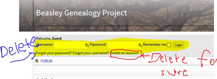

I have a Joomla site using Community Builder for user management, coupled with Kunena. There are times I need to limit new registrations, so I don't publish the the registration link on the CB Login Module. However, it still appears on the Kunena page. Since CB controls user login and registration, I'd like to remove that from Kunena. How do I do that?

No, I don't think I'm making myself clear. Mainly, I do NOT want users to "Create Account" from the Kuena link. It would be fine if there was no logon place on Kuena at all. Since Kuena takes it's login from Joomla (or CB), I have no use for anyone logging on from Kuena. And I definitely don't want them to "Create Account from Kuena. I don't want any changes in Joomla or Community Builder... ONLY to remove Create Account from Kuena.

dbeezley wrote: Mainly, I do NOT want users to "Create Account" from the Kuena link. It would be fine if there was no logon place on Kuena at all.
This is what I was trying to explain. Yes, I agree with you. I think the best solution in your case is to disable (remove) the "Kunena login form" from your forum and let users use the CB Login module instead.
I am guessing (because you have not posted your configuration report ) that you should use the forum integration settings as I showed you in my earlier reply. Did you make those changes?
