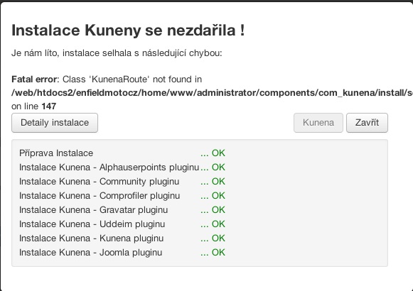

I was repeatedly unsucessful to instal current version in Joomla 3.3.0. I also tried to upgrade Joomla to 3.3.6, but it failed again. I am sending log file, it is in Czech language, but I think for you is important error message. Thank you for any advice! :whistle:

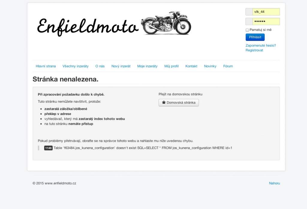

I also noticed that content of my webiste www.enfieldmoto.cz disappeared and there is displayed following message:

11 years 4 months ago #161573 by 810
clear cache on the joomla backend, and try again.
If not working, then uninstall kunena and install kunena again.
