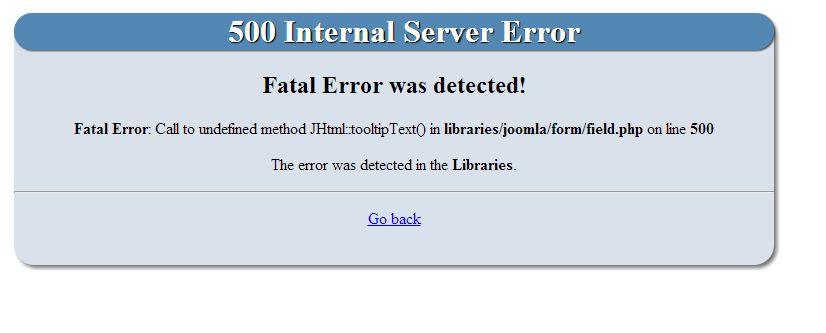

all instance killed the layout of admin(back end) of joomla
500 Internal Server Error
Fatal Error was detected!
Fatal Error: Call to a member function getFieldset() on a non-object in components/com_kunena/template/joomla30/templates/edit.php on line 70
The error was detected in the Kunena Component.
For support click here: Kunena Support

it was a fresh install(quickstart) with latest kunena, NOT an upgrade.
same error AFTER over wrote quick start with lastest joomla version from joomla.org
error occurs after component install, finish install, open up kunena ADMIN, click on template, click on default template to edit then error occurs. kills layout of admin, all links run down left side

Try that, it should fix it, in administrator\components\com_kunena\template\joomla30\templates\edit.php replace :
<?php if (count($this->form->getFieldset())) : ?>
by
<?php if ( $this->form instanceof JFORM) : ?>
