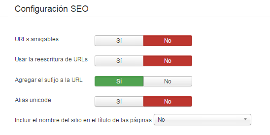

My configuration is this ....
I can not activate the sett friendly url or Use URL rewriting because I do not work anywhere.
As for sh404SEF before installing it also had the same problem with kunena.
This problem I have from the beginning and tired of testing and notify the server, it told me that I get in touch with you.
9 years 1 month ago #7 by 810
because I do not work anywhere. ?
1) Rename the htaccess.txt to .htaccess
2) Enable sef options in joomla global configurations
3) Enable sef on Kunena configuration
9 years 1 month ago #8 by ismael
1) When changing to .htaccess gives me error in the web: Internal Server Error /
The Server Encountered an internal error or misconfiguration and was Unable to complete your request.
2) If I enable joomla sef gives me error on the web: The requested URL was not found /descargas.html on this server.
3) I enabled kunena sef, url but still gives wrong
there must be some solution
thank you very much
