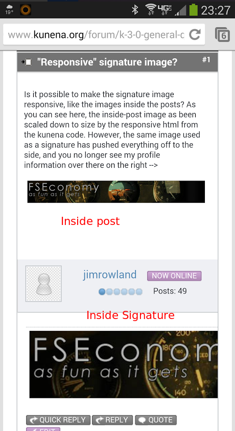

Is it possible to make the signature image responsive, like the images inside the posts? As you can see here, the inside-post image as been scaled down to size by the responsive html from the kunena code. However, the same image used as a signature has pushed everything off to the side, and you no longer see my profile information over there on the right -->

But there is already one built into Kunena. If you view this thread on your phone, you will see that my image inside the above post scales down beautifully. Kunena is doing that already. Inside the post, but not inside the signature area.
Each of those images were linked to the same URL... the one inside the post scaled, the one inside the sig did not. As you can see from the below screenshot taken while viewing this topic on my phone.

Try adding this to your Blue Eagle kunena.responsive-min.css
#Kunena div.kmsgsignature img {max-width:100% !important;}
It's something that is being worked on - here is the Github report (made today)
github.com/Kunena/Kunena-Forum/issues/2353
