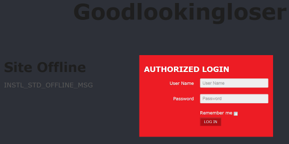

(2) When I tried to look at your site, there is not much that I can see because of this message:

Also turned off maintenance mode so it can now be tested.
