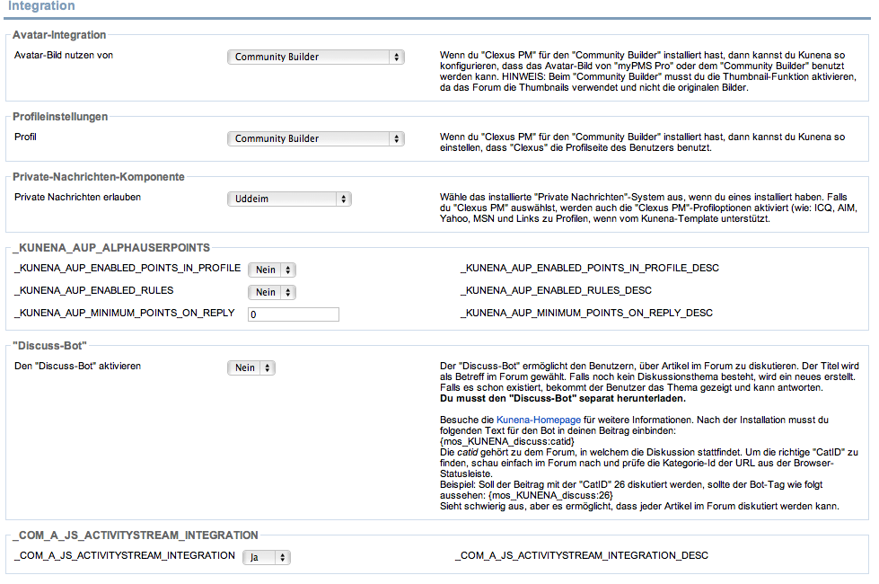

14 years 5 months ago - 14 years 5 months ago #123010
by nokumo
Replied by nokumo on topic Remove "register" from header!
Like this?
Problem: He don't´s save the the Change!

14 years 5 months ago #123015
Replied by sozzled on topic Remove "register" from header!
Yes, like that. But you also have to change the Community Builder documentation, too, to disable the standard Joomla registration facility and only use the CB registration facility.
Like this:
Global Settings » System » User Settings » Allow User Registration = No
CB Configuration Manager » Registration » Allow User Registration = yes, independently of global site setting
And these things should work
Like this:
