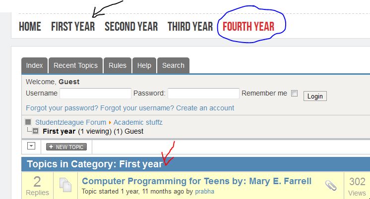

Hey, when I tried it for the second time, its not working again, here is what I did,
1 . I created an entry page menu for kunena.
2. I created category menu which I want to display and made it submenu of the above menu.
3. I changes the default menu of menu created at step 1 to the submenu created above.
4. I repeated this again for another category menu too.
But when I click on the menu in front end, I see the active menu color is wrong. Its always the last menu which is active.
Please help me understand. Thanks

Thanks for the reply, my problem was from the sh404sef component, when I changed the configuration of sh404sef to use joomla router for sef url, the active menu was pointing correctly. The default sh404sef plugin is causing problem with kunena active menu I guess.
