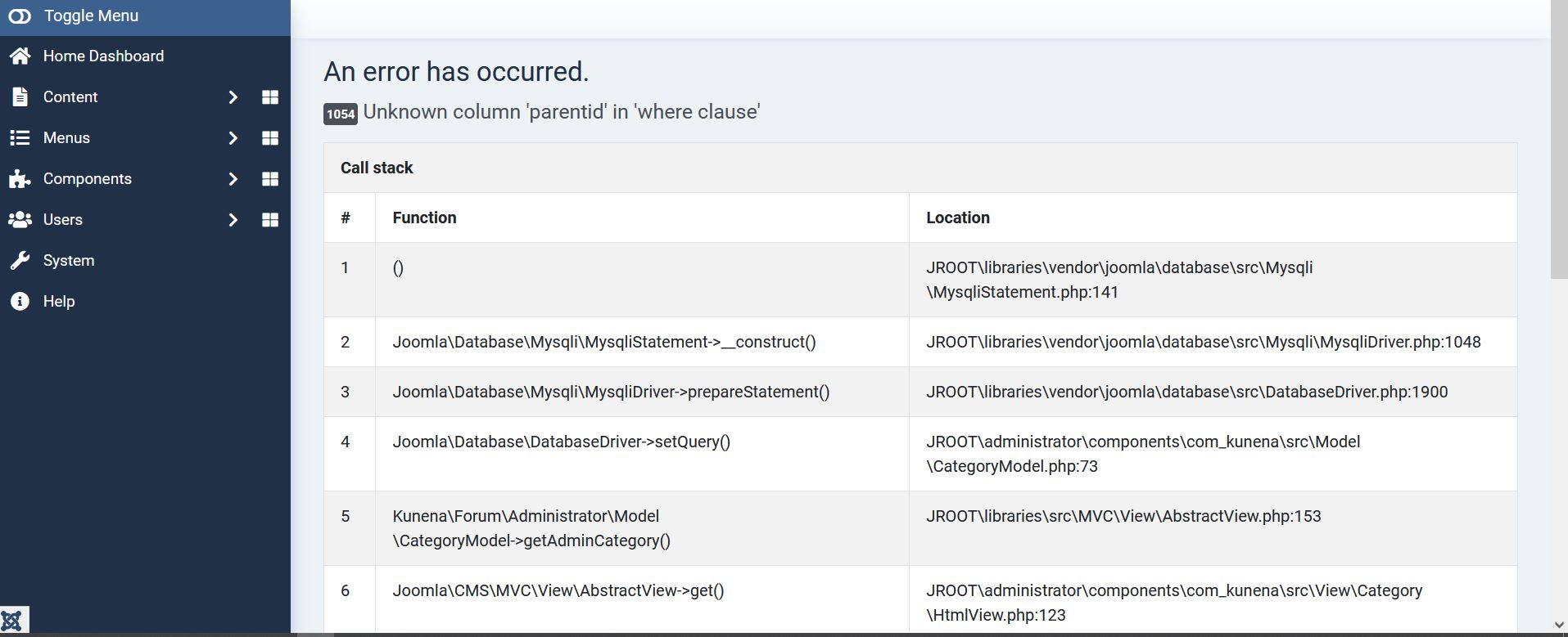

Question 1054 Unknown column 'parentid' in 'where clause'
4 years 8 months ago #222272 by rambro
Hi all,
I am testing out a joomla 4 website on my local computer via a winamp server before going live with it. I have kunena 6.0 beta7 2022 installed on it. When I try to create a category I get an error message. I will attach the error message to this post/thread.
I was wondering if you can help me to resolve this matter. Thank you.
Rick Ambrosino
4 years 8 months ago - 4 years 8 months ago #222273 by rambro
Hi all,
I had attached file attachments but they did not go through, so I posted the problem here. Thank you.
Rick Ambrosino

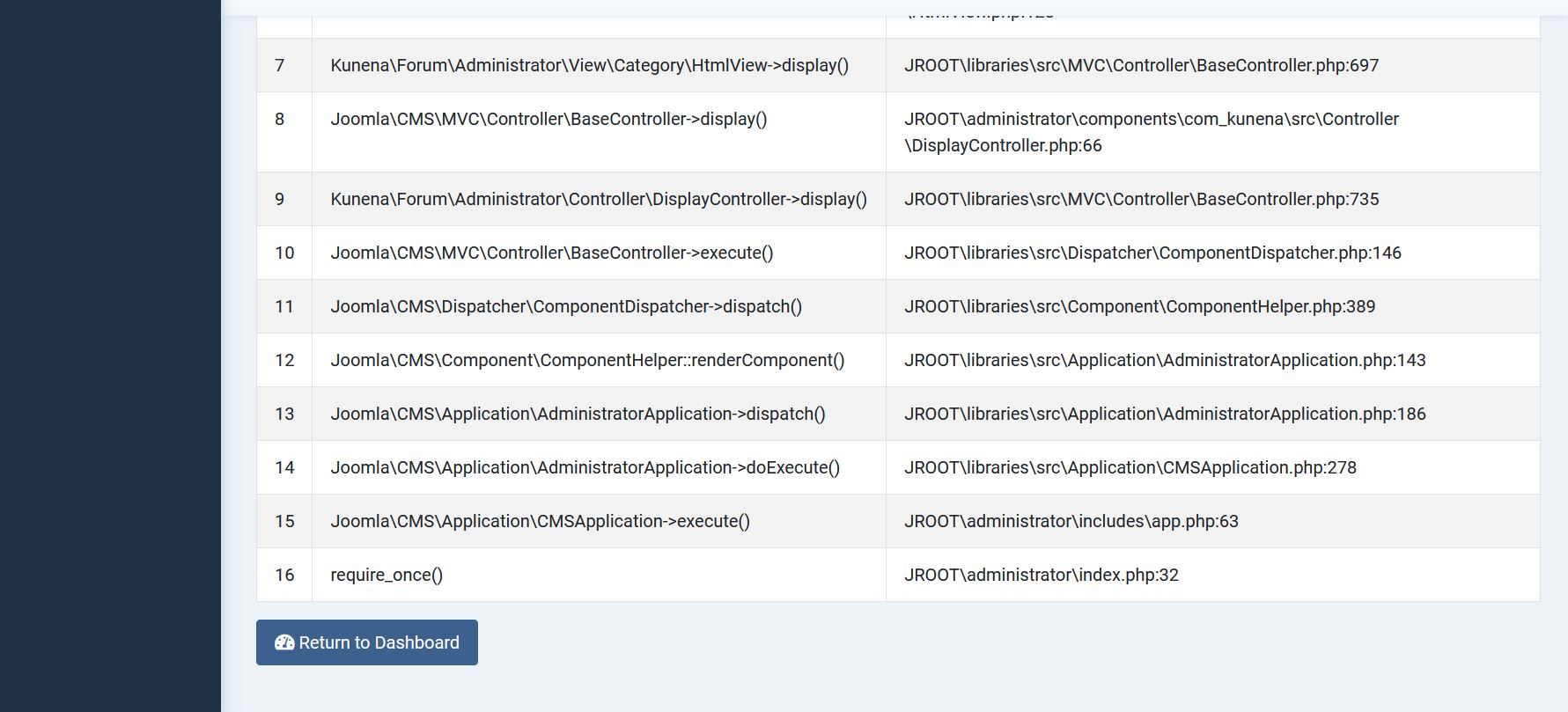

# Function Location
1 () JROOT\libraries\vendor\joomla\database\src\Mysqli\:141
2 Joomla\Database\Mysqli\MysqliStatement->__construct() JROOT\libraries\vendor\joomla\database\src\Mysqli\:1048
3 Joomla\Database\Mysqli\MysqliDriver->prepareStatement() JROOT\libraries\vendor\joomla\database\src\:1900
4 Joomla\Database\DatabaseDriver->setQuery() JROOT\administrator\components\com_kunena\src\Model\:73
5 Kunena\Forum\Administrator\Model\CategoryModel->getAdminCategory() JROOT\libraries\src\MVC\View\:153
6 Joomla\CMS\MVC\View\AbstractView->get() JROOT\administrator\components\com_kunena\src\View\Category\:123
7 Kunena\Forum\Administrator\View\Category\HtmlView->display() JROOT\libraries\src\MVC\Controller\:697
8 Joomla\CMS\MVC\Controller\BaseController->display() JROOT\administrator\components\com_kunena\src\Controller\:66
9 Kunena\Forum\Administrator\Controller\DisplayController->display() JROOT\libraries\src\MVC\Controller\:735
10 Joomla\CMS\MVC\Controller\BaseController->execute() JROOT\libraries\src\Dispatcher\:146
11 Joomla\CMS\Dispatcher\ComponentDispatcher->dispatch() JROOT\libraries\src\Component\:389
12 Joomla\CMS\Component\ComponentHelper::renderComponent() JROOT\libraries\src\Application\:143
13 Joomla\CMS\Application\AdministratorApplication->dispatch() JROOT\libraries\src\Application\:186
14 Joomla\CMS\Application\AdministratorApplication->doExecute() JROOT\libraries\src\Application\:278
15 Joomla\CMS\Application\CMSApplication->execute() JROOT\administrator\includes\:63
16 require_once() JROOT\administrator\:32
Last edit: 4 years 8 months ago by rambro.
4 years 8 months ago #222278 by rich
Please try it with the nightly build. You can find it at bottom on our download page.
