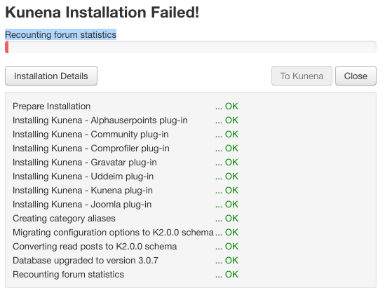

I know I'm late but I need to upgrade a Kunena Forum from 1.7 to an actual version ... so i read the instructions I found here in the forum.
I installed a fresh new Joomla 3.64 system and imported the users around 7500 ... works well
Now I copied all Kunena database tables to my fresh Joomla and changed prefixes of the tables.
I started to install Kunena 3.0.7 and than the installation breaks after Recounting forum statistics
the forum has ≈17700 messages in ≈3500 topics
Hope somebody maybe had the same problem at that installation progress step and can help?
thank you very much!!!

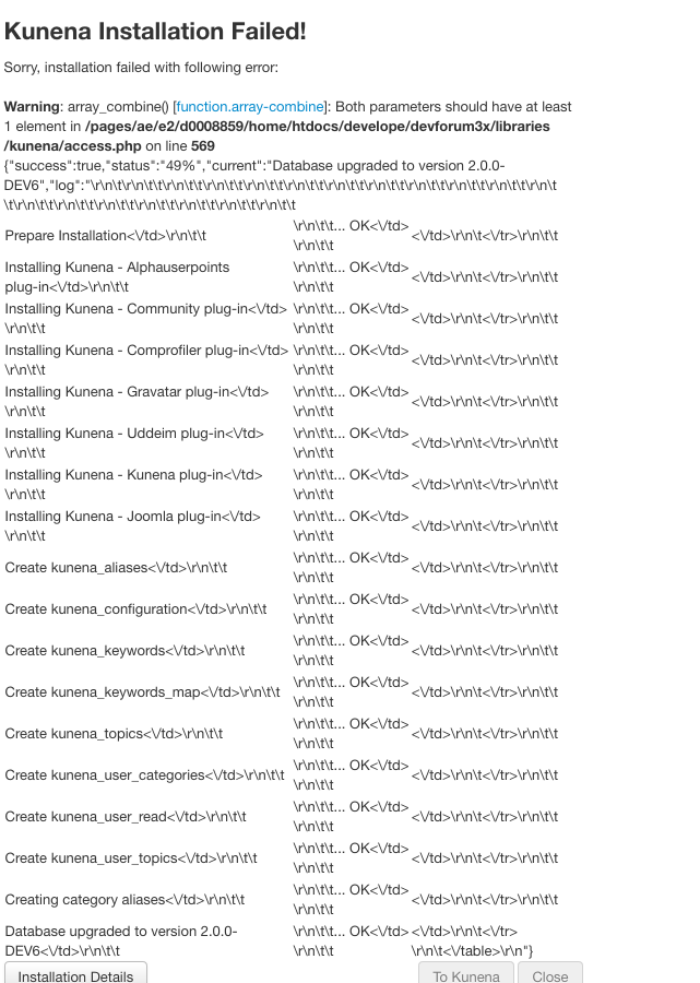

I tried to proceed if I commend out $read[$id] = array_combine($list, $list);
than the database update runs through 4.0.12 ...
after that I'll get to the same error as with 3.0.7 it breaks at same step like shown in my first post ...
