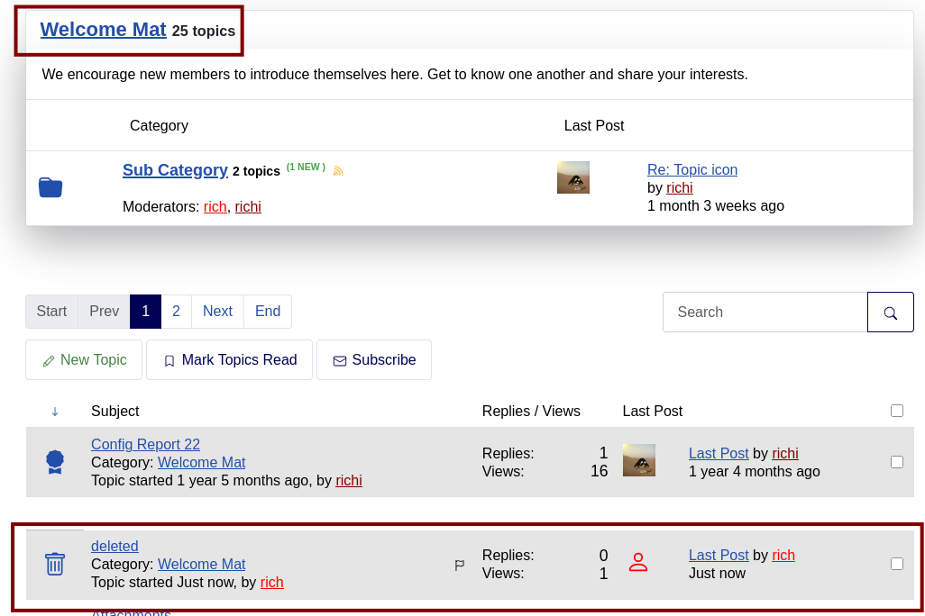

When I click on the moderation button, two options appear - actually moderate and delete. In the first case, I can move the post or topic to another location, and deleting makes the post gray, that is, invisible to non-administrators. The problem occurs when the "deleted" (gray) post is the only one in the topic, or when all posts in the topic or the entire topic is "deleted" (gray). In these cases, as an admin, I cannot see it, and I can not return it to the forum, if I wish.Oh, that's what you meant. You can use this button to perform moderator actions such as deleting, moving, etc., but the topic will not be marked as moderated.

If all posts in a topic are deleted, the entire topic counts as deleted and is no longer displayed in Recent Topics. You can find the deleted topics via the index page if you know the category (see image below).When I click on the moderation button, two options appear - actually moderate and delete. In the first case, I can move the post or topic to another location, and deleting makes the post gray, that is, invisible to non-administrators. The problem occurs when the "deleted" (gray) post is the only one in the topic, or when all posts in the topic or the entire topic is "deleted" (gray). In these cases, as an admin, I cannot see it, and I can not return it to the forum, if I wish.
Or do you mean something else?
It is even easier if you create a new Kunena menu tab:
1. go to the Kunena Menu and click on New
2. select Kunena Menu Item Type = Recent Topics
3. select View = Deleted Topics
4. Parent item = Forum
5 Status = Published
5. access = Special or Super Admin
