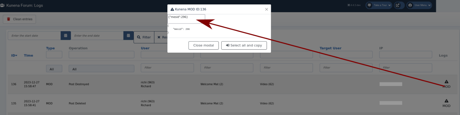

2 years 10 months ago - 2 years 10 months ago #230416 by rich
Moderations can be logged in the backend. To do this, the option "Define if you want to log action or moderation" must be enabled in the configuration (Users tab). In the logs you can see whether a moderator has deleted or permanently deleted (Destroyed) a post.
If you then click on the MOD symbol on the right, the post ID is displayed in a modal window.
