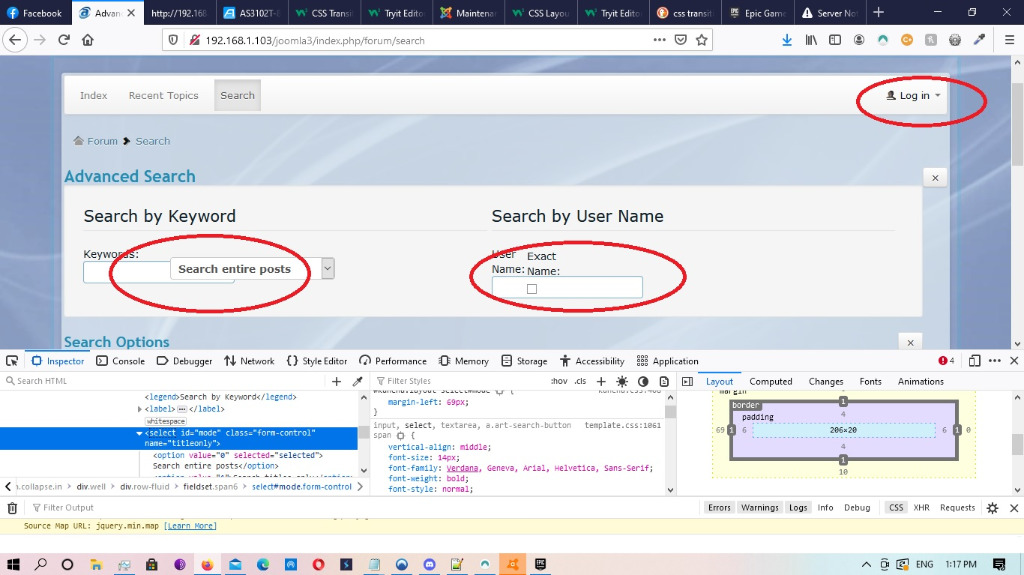

Hi, I am having an issue with 2 elements with kunena layout.
1. Is the layout of the advanced search section on the search menu item.
2. The login button on the nav bar doesn't seem to be working correctly.
I have attached a photo and the configuration report.

Which Bootstrap version use your Joomla template? Maybe there is a CSS conflict, but that's cannot be seen in a picture. Have you a link to your forum?

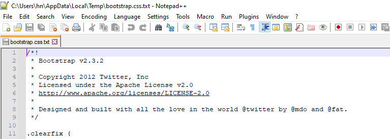

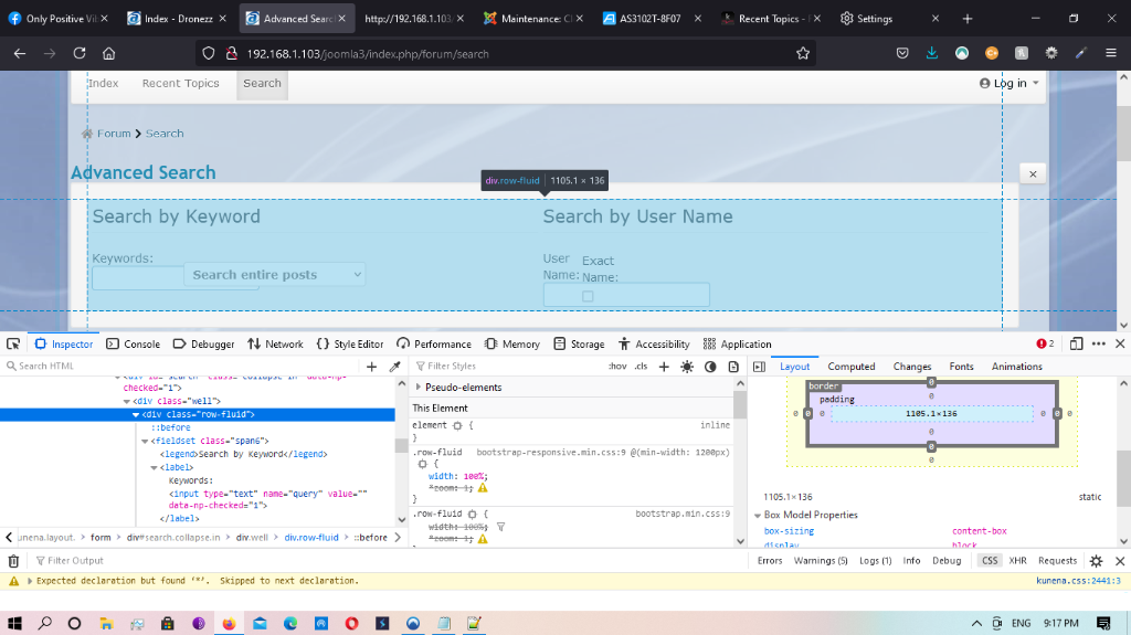

Hi again, unfortunately the site isn't live so I can't link you. But I have narrowed it down to this element of the search page (see pic)Also, I am using this version 2.3.2 of bootstrap but it appears the site is using bootstrap.min.css rather than bootstrap.css? (see version pics)

Try to disable the option "Load Bootstrap CSS" in the Crypsis setting.
Or search the issue with the method of elimination. Test it first with the Joomla default template Protostar. Is the error still present, disable all non default extensions one by one, to find the cause.

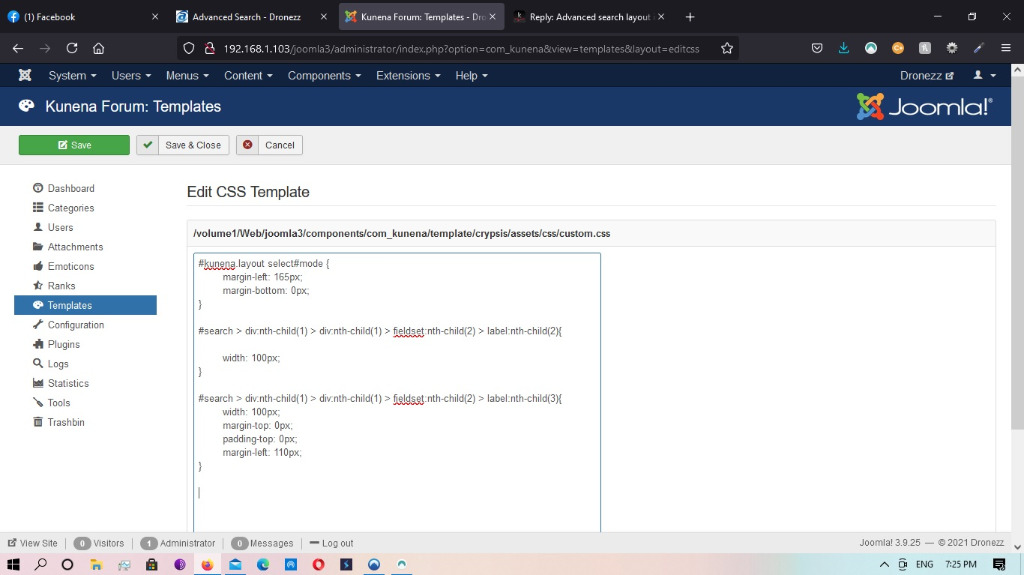

Hi again, Thanks for all your help rich. I managed to fix the problem with some funky css lol.
I have attached an image so you can have a giggle at my css skills!
it's working on desktop but i shudder to think what it will do responsively?

5 years 5 months ago #217785 by rich
Is there a way to separate the custom.css between responsive and desktop mode?
Yes, it's possible, if you address it to the desktop size.
In this example, the code effect begins from a size of 1024 px.
@media (min-width: 1024px) {   #kunena.layout select#mode {     margin-left: 165px;     margin-bottom: 0px;        } }
