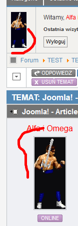

I want to use animated gifs as avatars and I do not want to Kunena reworked it to me.
On my forum I use a gallery avatars, I would like to receive the address directly into the selected avatar and permanently disable the automatic avatars size change in avatars/resized (This creates unnecessary files).

Hi
I do not want to be limited
I have animated gifs smaller and larger, for example
/media/kunena/avatars/gallery/Uzytkownicy/caage1.gif
I know that the script creates
/media/kunena/avatars/resized/size200/gallery/Uzytkownicy/caage1.gif
but also
/media/kunena/avatars/resized/size36/gallery/Uzytkownicy/caage1.gif
Where is the function of copying and changing ?
If I do not get help I'll be looking for "/resized/" in PHP but I'd have to get all files on disk. I thought, here I get such information.
"and I do not want to Kunena reworked it to me." ? >>
I want to use CSS for resize images, not PHP code
